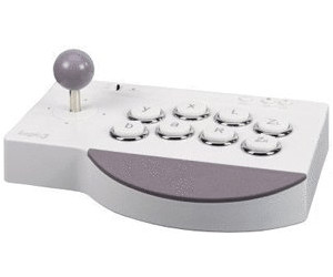

I've been looking in to getting a wii arcade controller, like the one pictured, connected tom my beebs.
Looking at the photo's in Paul's post I've deduced the following:
