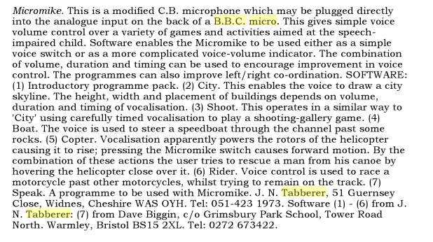

Post by OneSwitch » Thu Jul 02, 2015 6:14 am
Fantastic!! Thank you so much for finding this (to me) lost treasure.
If you ESCAPE then knock out the MicroMike PROC and ONERROR lines you can actually see what the games looked like. But I'm hoping for better than that. Looks like the original microphone controller was an adapted CB Microphone, that connected to the analogue port...
https://books.google.co.uk/books?id=QNA ... er&f=false
I don't suppose anyone has any thoughts on what pins it might connect to on the analogue port?
Also, I don't suppose you had any other special education disks, such as "Speak" along with your MicroMike disk?
Anyway, huge thanks. Brilliant find!

Post by 1024MAK » Thu Jul 02, 2015 6:49 am
Would be interesting to see what the software does with analogue joysticks plugged in :?
Anyway, going on what was said in that extract above, the mic would have been connected to an amplifier/limiter/conditioning circuit, then fed to one of the analogue channels on the analogue port.
