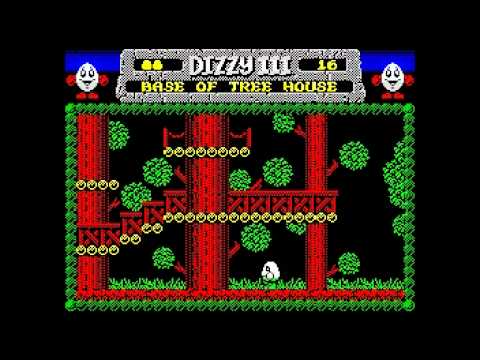

I share the analysis above: Dizzy was probably never available for the Acorn machines because the extra development effort required by the tighter memory footprint wasn't justified by the potential sales by the time Dizzy arrived in 1987.
Despite the far-and-wide porting reported above, the original was only a C64, CPC and ZX Spectrum game, and that remained the full list of 8-bit micros for official releases. Everything else is a fan effort.
The fun speculative part:
The early Dizzy games use tilemaps for their screens; having had a quick look at the map for Fantasy World Dizzy there are 58 screens total. On the Spectrum each screen is 30 columns by 17 rows and there are clearly a lot more than 16 tiles so naively let's say an uncompressed 58*30*17 = 29,580 bytes of map data alone.
The final two 8-bit games were written by a different team and switched to a Citadel-esque vector description of screens in order to fit more than 100 in but the change is pretty obvious. So I don't know that Citadel provides a useful data point on the storage issue.
I guess it's not impossible you'd be able to compress the map data enough to fit into a 32kb machine though, if you were happy with Mode 4 or 5-esque graphics? I think it might need to be a manual job though; if you look at something like the image below then you or I could encode it as a painter's algorithm-style three tree trunks, add branches and leaves, overpaint barriers and floor, and fit that into less than 510 bytes.
That said, I wouldn't be surprised if you ended up needing to abridge the original content.
Supposing you wanted to do that, Codemasters have been very enlightened as to fan titles: as long as you acknowledge the copyright owners and don't seek to profit, they won't intervene. There's active engagement with the fans by the Oliver Twins — the recent Wonderful Dizzy is a collaboration with the team that previously remade Crystal Kingdom Dizzy.
Otherwise: I once wrote a Dizzy engine in C and used it to reproduce some of my favourite segments. The actual logic at play in terms of character movement and collisions isn't especially complicated — it's a fixed height jump, fixed speed left and right motion, and a simple slow upward push whenever Dizzy's feet are over an occupied square, or a complete exclusion if at least two thirds of one side of him has entered an occupied section. He spins when he jumps and continues spinning (and moving) until both he's the right way up and his feet are on top of solid ground. I forget whether he's normally timed to do exactly one loop or exactly two when jumping on a flat surface. Probably two.

To the extent that it adds anything, which it probably doesn't, I eyeballed the Dizzy sprite and it's at least 21 frames all in, around 24x24 at Spectrum resolution — so assuming you'd end up in Mode 5 on a BBC or Electron, I guess that'd likely be 12x24.
There's some scope for composing it of smaller common elements, but the jump animation isn't amenable to that due to the body rotation.
So all in, allowing for an appropriate form of compression, I reckon you're talking at least half a kilobyte.
Most of the other sprites are just a single frame, a few are two.
Posts: 5150
Re: Why was dizzy series not on the Beeb
Post by tricky »
I think that you could store everything at 1 bit and probably cheaply mirror too, but it is still a lot!
ThomasHarte
Posts: 532
Joined: Sat Dec 23, 2000 5:56 pm
Post by ThomasHarte »
tricky wrote:
Mon Feb 22, 2021 7:40 pm
That was with mirroring factored in, though I misremembered the 21, that was before making cuts to get to 18. The minimum of frames you'd need somehow to be able to draw, to get the same animation as other platforms is two frames for standing still, an eight-frame walking animation, seven additional frames for the jump (for eight directions total, one of the walking steps being used for upright), and at least one to represent shock after hitting the ground from a great height.
That said, I've clearly forgotten to allow for rotational symmetry in that jump animation. So you could trim there with rotate-by-90 and rotate-by-180 sprite plotters, assuming you can get those below the cost of six additional images.
I think that if you did it by hand you could probably separate out the body and limbs, but I didn't see any obvious substantial savings there if it were a pure question of data.
EDIT: specifically, I was eyeballing the sheet below which, as the text says, is from the C64 version of Crystal Kingdom Dizzy. No need for the two swimming frames for most titles in the series,four frames for the rarely-seen fell-too-far animation could be just one with limited gameplay effect, and looking more closely the walking animation isn't actually eight unique frames. So I've actually done terribly at my estimation. Assuming the rotation-by-multiples-of-90 code I think it'd be:
  • two frames for standing still;
  • one for fell too far;
  • four for walking;
  • two for jumping.
Which is actually only 9. And most of them are 21 pixels tall rather than 24, but none is 16 or fewer across, so actually even the very naive storage is less than half a kilobyte. I was way off.
