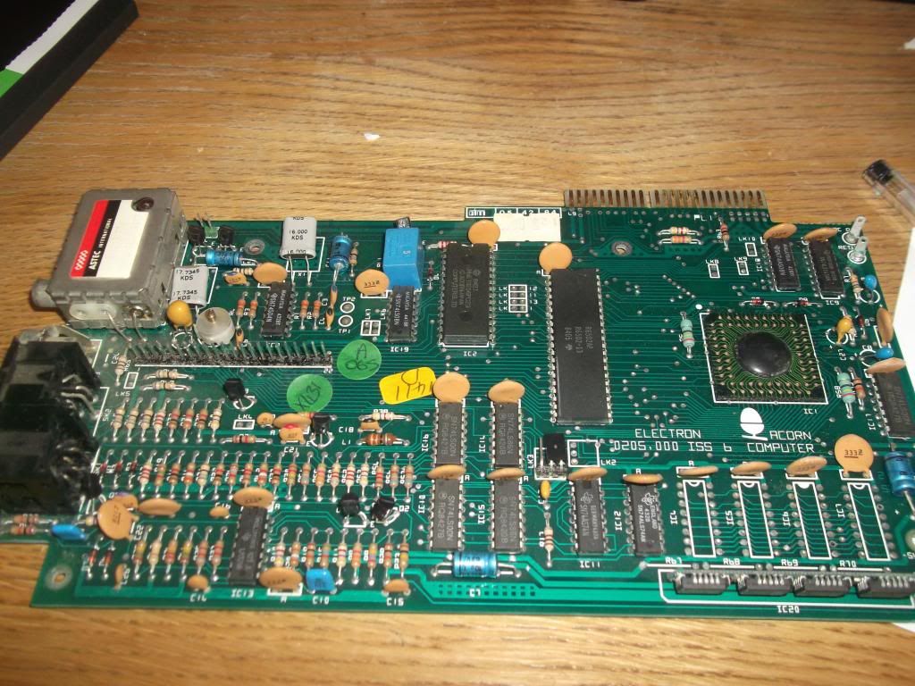

Hi all.
I'm busy desoldering my cpu so I can fit my turbo board and I've noticed that Daniel has fitted his to an issue 2 motherboard whereas mine is an issue 6. There seems to be a significant difference in the layout and lk8 is only 2 holes and on the top right of the pcb, nowhere near the rom. Any ideas what difference this will make?
Please don't say I've got to desolder the rom as well
Re: Fitting slogger turbo driver
No, you don't - you've got an issue 6...

ISSUE 1 boards (German) and ISSUE 6 boards
Locate LK13 which is to the right of the Acorn ROM in a group of
four Links. Turn the Electron board over and note that the left
and right hand holes of this Link ( as viewed from the component
side ) are joined together by a track. This track must be cut VERY
CAREFULLY using a Stanley knife or equivalent. Remove the solder
from these two holes
