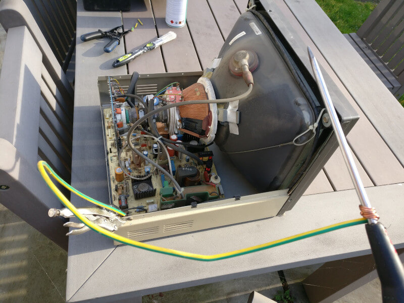

Back when servicing CRT displays was common, some engineers and some companies used a purpose made discharge probe. Or in some TV repair shops they made their own.
It is basically just a suitable high voltage resistor, a metal probe with an insulated handle and a wire with a croc clip on the end.
But most engineers just used one of the two methods described in the posts above.

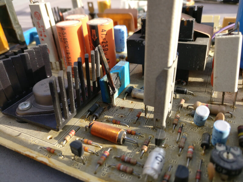

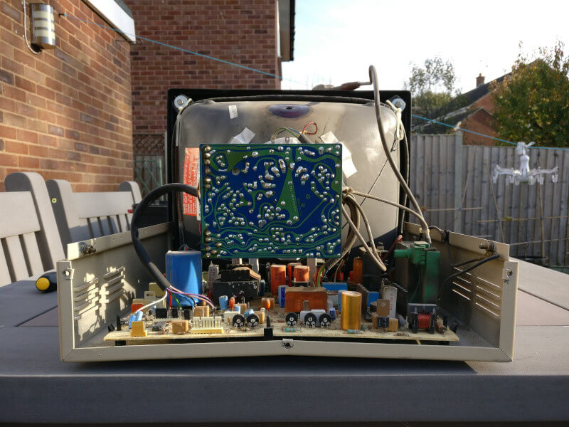

As it was sunny out and this thing was full of a thick layer of grime I decided to do the de-energising thing and stripdown outside. Completely uneventful - not even a "crack". I was a bit disappointed after all the build up :lol:
I did make a pretty interesting discovery - I knew the bottom of the case was bent but didn't realise it was actually putting pressure on the main PCB. One component (labelled R12) had actually completely broken free from 3 of its 4 solder joints and was flapping around. It had obviously been leaning on another component (labelled C17) at some point and scorched it! :shock:
So glad I decided to strip this thing down... The scary part is it was actually working in this state!
Thankfully the PCB traces all look fine and it was just the solder that had cracked. These old electronics are pretty tough. I ordered the new LOPT from Donberg in the end so I'm waiting for that to arrive now, I think R12 is some kind of radial ceramic power resistor and C17 is an MKP1841 film capacitor so I'll have to hunt those down too.

I just wanted to add that I've now finally replaced the tripler as well as the LOPT and that scorched capacitor from my previous post. It turned out that the capacitor was the wrong value so I replaced it with the correct one as per the service manual.
What a difference!
The monitor is now pin sharp and stable right from initial switch-on, with the high pitched whine massively reduced (it's still there, although it does fade after about 10 mins - or maybe I just get used to it). The picture quality is night-and-day. Will try to get some pics but the ones I took with my phone last night don't really do it justice.
