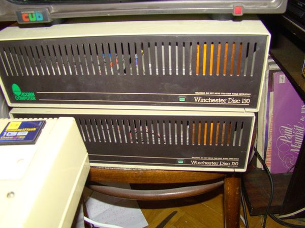

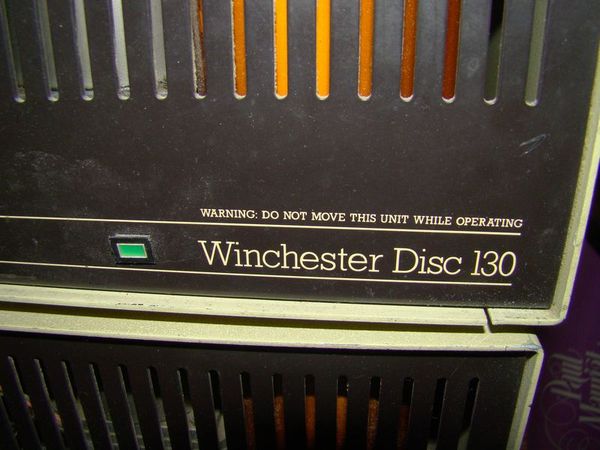

I have 2 SASI ( ST-506) hdd with Econet level-3 partitons.
But my Econet clock no working and i no able to access to files only to ADFS prat of disk localy.
Is it any way connect HDD to PC via ST-506 HDD controller and make disk dump for access to it in BeebEm or ADFS explorer or some way extract files to PC as file file.inf format for preserver soft on this hdd ?
I want extract all files from econet part of disk to PC then reformat HDD as ADFS only and back to it all files from PC.

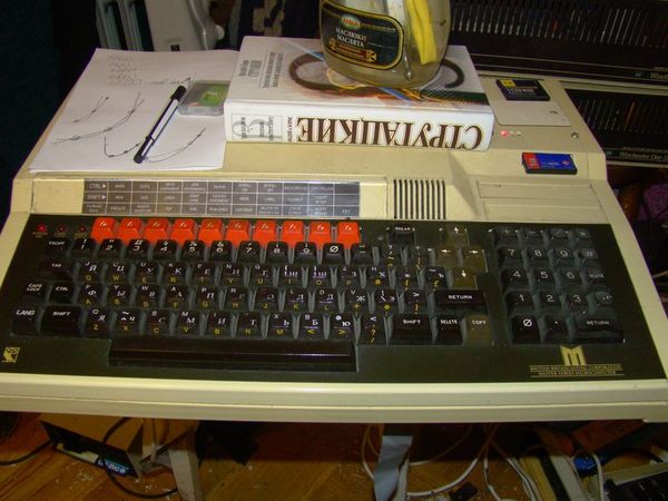

Our Ukrainian Ministry of education in 1985 get some BBC model B and Master-128 for put as test in Kiev school for teach informatics.
Image my favorite game Castle Quest

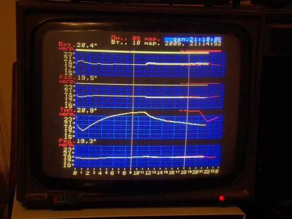

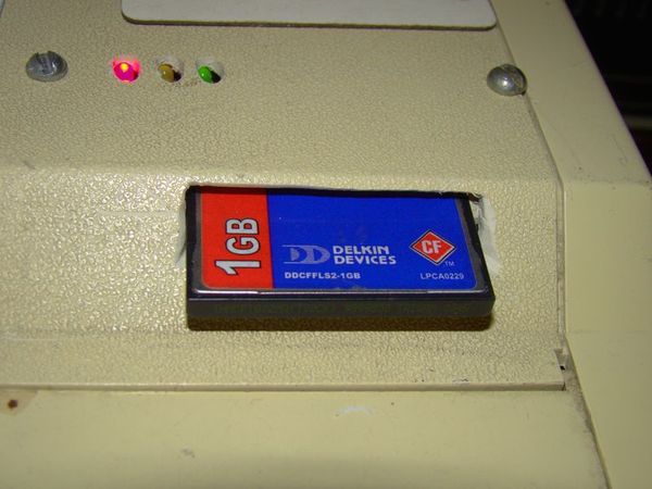

Image our program for control electric heating floor at office
ImageMaster-128 with IDE CF-Card adapter
Image CF-CARD on Master-128
Nice pics, hadn't seen Cyrillic keyboarded Masters before :)

I have program afsfiler but I need backup My Econet Level 3 Winchester 130 to PC.
So I need make some "mixture of a Bulldog with a Rhinoceros".
I mean look sources of afsfiler and xfer and make program for read files from AFS0 partiiton and over RS232 send to PC where save for backup like in adfsexplorer.
Do You have any ideas ?
I lost my clock, I have only Master 128 and 2 Winchester 130 sasi drives.
Or I need making very crazy harкdkor and soldering 1Mhz Bus controller for Raspberry Pi or USB to dump all hdd sectors to pc.
sincerely Yours Acorn BBC user from a distant independent Ukraine
