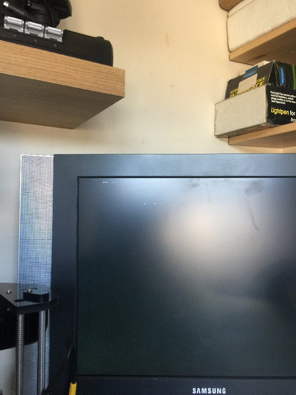

OK, I have now socketed the ROM and CPU.
Read the ROM content out and compared it to the ROM files and all looks OK.
WIth the original CPU in, with no keyboard connected: FULL WHITE SCREEN.
with keyboard connected: FULL WHITE SCREEN, LED lit or
WHITE HORIZONTAL bars, LED not Lit.
With new R65C02P3 in, with no keyboard connected: WHITE HORIZONTAL bars briefly then black screen, sometimes with a few flashing pixels.
with keyboard connected: WHITE HORIZONTAL bars briefly then black screen, sometimes with a few flashing pixels. LED lit
PS the Pixels are the same each time...

Hm, ROM RAM and CPU swapped out... have you checked the clock and reset signals for the CPU?

Think that is my next port of call..........
