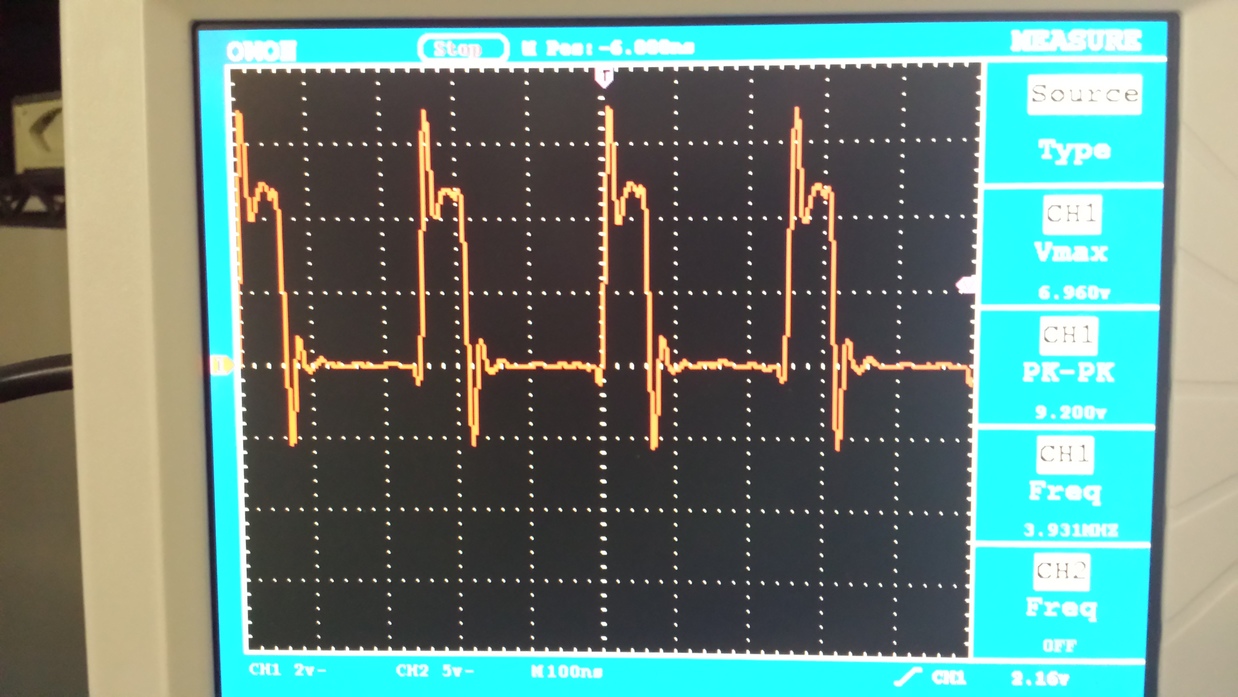

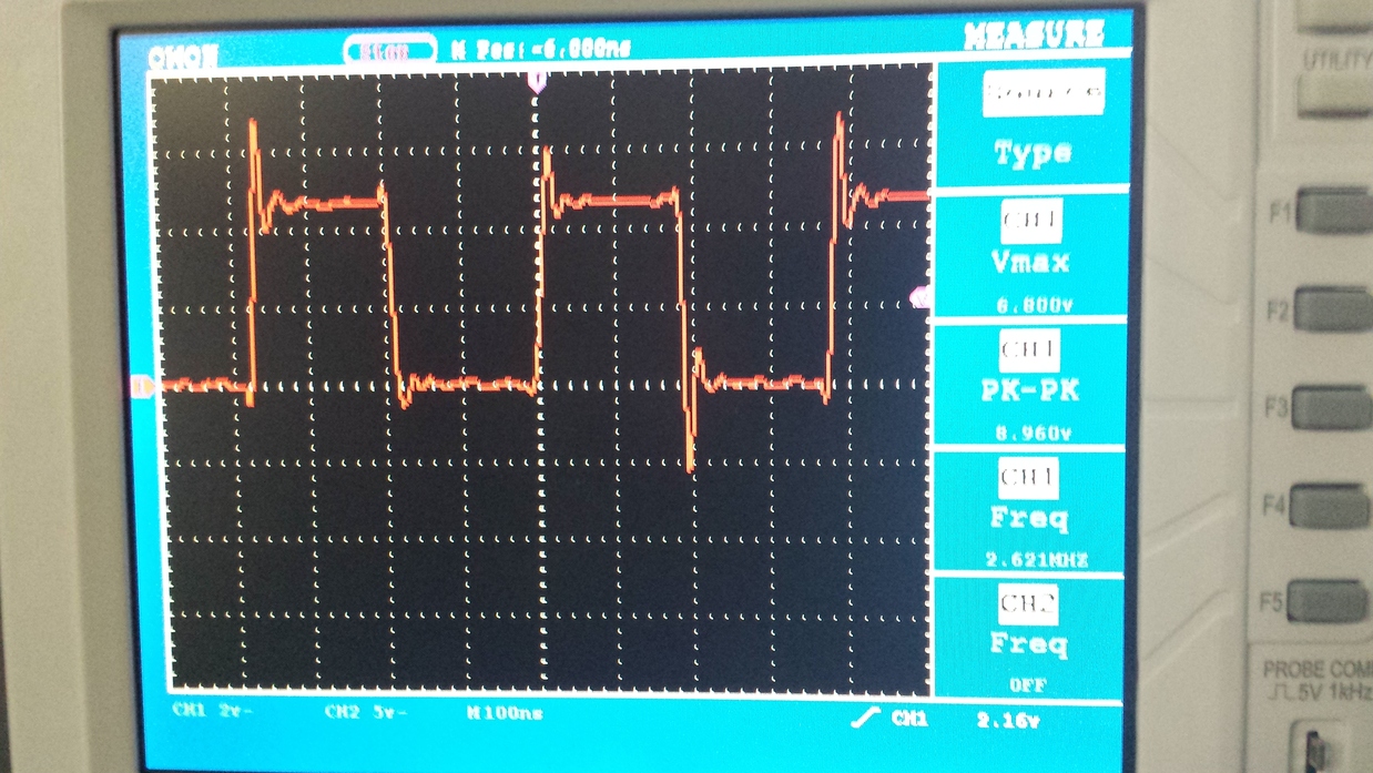

paulb wrote:Some of those libraries out there have the tendency to go "framework", meaning that the primitives are quickly buried under a load of "convenience" operations to supposedly make applications easier to write.
Very much this. When I was learning some basic Arduino tasks I wrote a program to flip a single channel back'n'forth (the pin that happened to be connected to the LED)
  void loop()
    boolean x=false;
    int y;
    while(1)
      x=!x;
      if (x) { y=HIGH; } else { y=LOW;}
      digitalWrite(LED_BUILTIN,y);
That resulted in a 70Khz square wave.
When I removed the call to digitalWrite() and flipped the bits directly:
  DDRD=B11111111;
  boolean x=false;
  while(1)
     x=!x;
     if (x) { PORTD=255; } else { PORTD=0;}
That went up to 748Khz; 10 times faster. It showed just how much overhead the standard library applied.
I then cheated and removed the logic and just flipped the pins back'n'forth
  DDRD=B11111111;
  while (1)
    PORTD=255;
    PORTD=0;
And that went to 3.9Mhz! Although the signal wasn't equal 'cos of how the assembly worked out.
If I stuck a couple of "nops" in to balance the signal out then I got a consistent 2.6Mhz.
If I disabled interrupts around that loop then it went up to 2.66Mhz, which is pretty much chip speed.
So we went from 70Khz up to 2.66Mhz just by coding closer and closer to the hardware.
