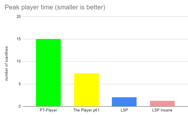

LSP (Light Speed Player) is a very fast Amiga music player. It can play any MOD file and outperforms all existing Amiga music player in speed
Interesting, but this is for the Amiga though, not the Archimedes, and is only compared to other Amiga based players. I don't have an Amiga so can't test this out, but having looked at the code I can see it only plays the MOD notes and doesn't support music effects. This will not reproduce most existing MOD music correctly, only those tracks written without extensive use of effects. And the custom file format it uses would seem to increase the size of the MOD file, for ease of playing...which looses the benefit of a smaller code player.
Avoiding use of music effects and stripping this code from the player was a standard demo optimisation BITD, I have a cut-down QTM like this somewhere, and with a good musician writing the MOD, it can still sound amazing.

are you sure that some effects are removed ?
the coder behind this work is a top coder, currently maybe the best coder on ST
he did this :
On ST :
https://www.youtube.com/watch?v=XJKDb4ByZ7Y
On Amiga :
https://www.youtube.com/watch?v=yRiFhDFFt58
edit : for what i understood, he changes the module to only keep the used effects. and in the fastest version, he generates the code to play each note/effect with code directly.
