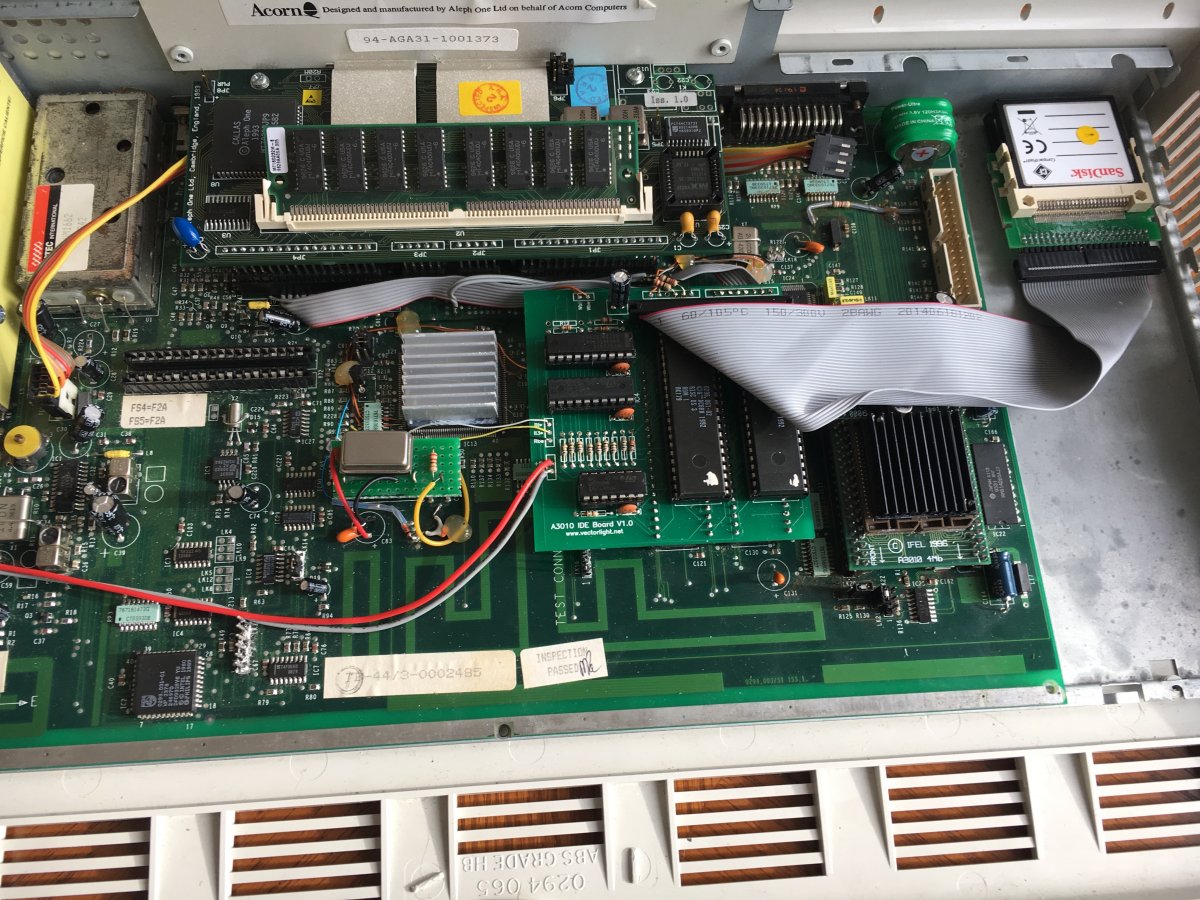

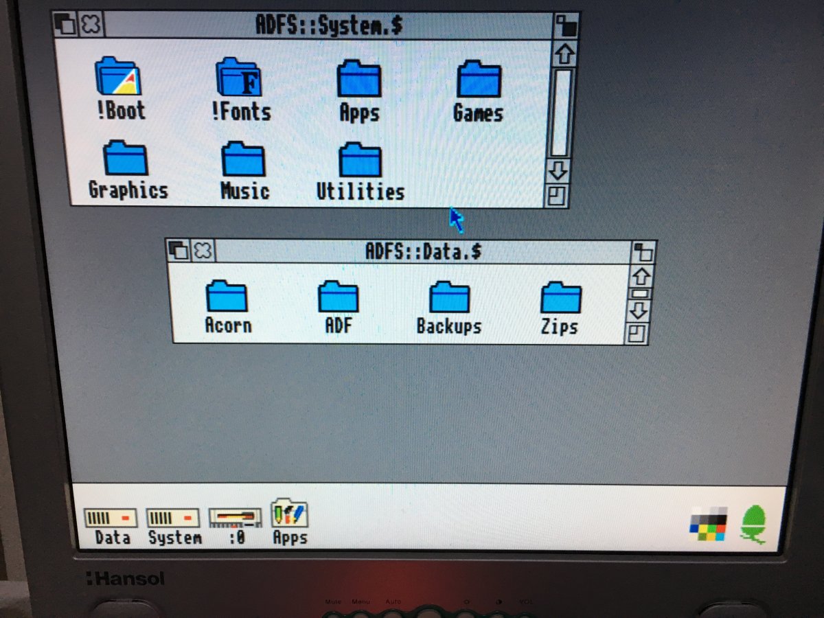

I've built a version of this myself and have had some success with it. I've used a slightly different approach to munchausen and have built a board that plugs into the ROM sockets which saves soldering a about 19 connections :D
Have booted it up today with a pair of known working CF cards and hey presto it works :D
I know, it could be a lot more compact. I've already re-designed it to use a lot less space :D
3D Printing and Acorn A3010 Owner!

It needs 21 wires soldering to various places including 7 on the ARM250 & controller chips which are quite tricky :shock:
SteveBagley wrote:A thought on this -- when I upgraded the memory in an Atari ST many years ago, the upgrade came with an adapter that you just pushed over the top of the chip to make all the connections. For a surface mount chip like this the adapter looked like an upside down socket on a PCB with a ribbon cable to connect to the RAM. I wonder if a similar approach could be used here…
Steve
Thats a great idea, if suitable adapters can be found to fit the ARM250. Failing that, 3D printing may offer a solution here. :D
I've been doing some tests, bulk copying files from one drive to another and it seems a lot faster than my castle interface in my other A3010. I guess its because this is in 16 bit mode :D

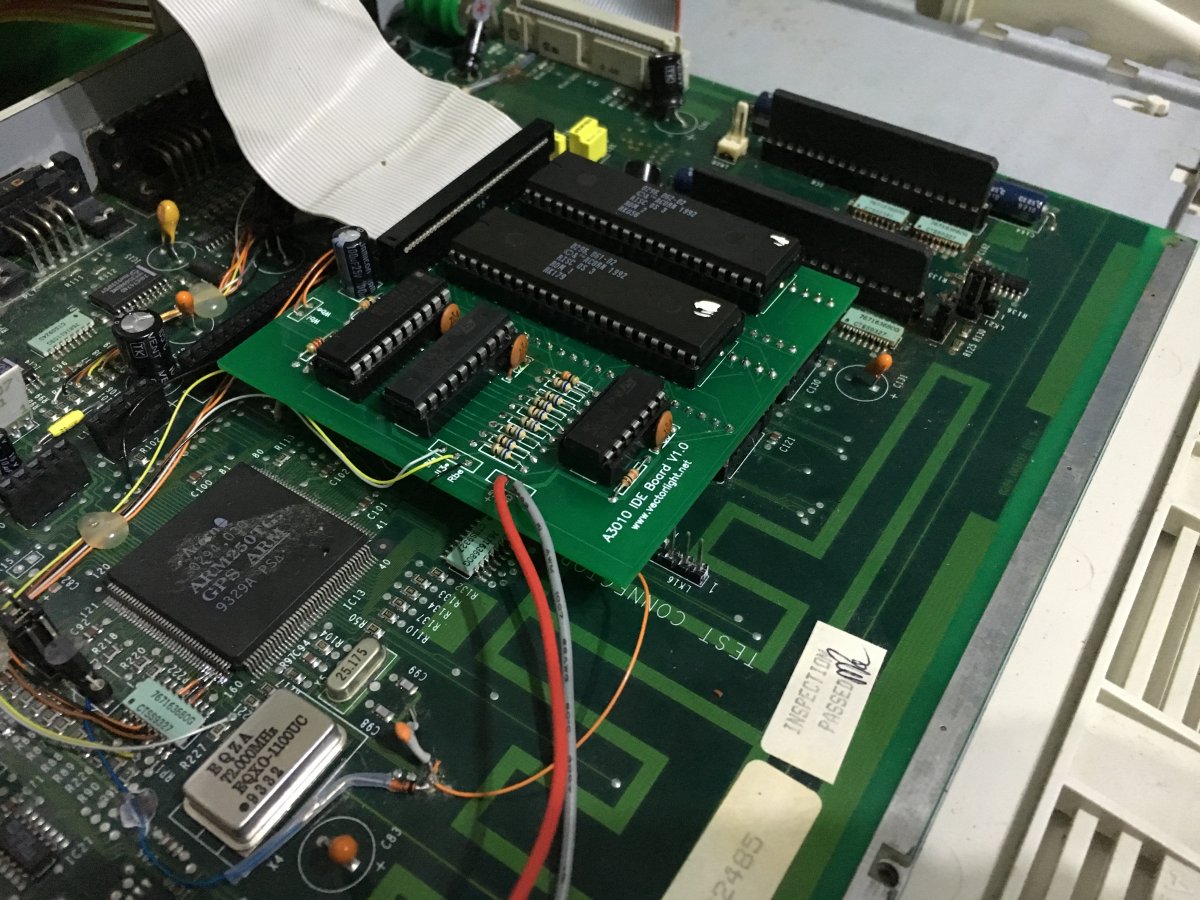

Thanks! My wiring is the same as the A3020 diagrams plus resistors on IOR & IOW as you've done. Have you managed to try a CF card that is known to work? The main differences to what I've done is:
1. Use BD0-6 from the points behind the mini podule (top-side) rather than underneath off the podule connections themselves.
2. RST comes from the top of the board near the 72mhz crystal where there is an existing factory mod.
3. Mount the board on the ROM sockets and use D8-15, D24-31 and also LA2-4 off this as well.
4. Add a HCT14 to the board and run I!3* straight to this rather than using the IC on the A3010 board. (Just trying to keep all the wires as short as possible.)
5. Used a IDE-44 pin connector
I do actually have an issue with my implementation in that some CF cards (that I've used with my Castle IDE card no problems) cannot be accessed with this modification, the error is saying the drive isn't formatted. So I think there is something not quite right with what I've done :( Most cards work fine though so its all a bit wierd. :shock:
The cards that do show up work great, I've done lots of copying of files from one drive to another and all the software I've run from the drives loads perfectly.
As I've mounted it on the ROMs there isn't much room for the card, I have had to run the cable over to the right-side (where your board is) and put the CF cards there.

Yep I've formatted several CF cards and also a really old mechanical drive and placed files on there which work fine when run.
I'll happily send you the old 80MB drive and 128MB CF card which I've formatted using my interface FOC so you can test if you want? :D

My final bit of testing of this was to install a PC card and make sure there were no issues: :D
My 26mhz mod makes this look more messy than it should be :shock: I ended up moving the wires for BD0-6 to the podule like munchausen's design as the PC card seemed to cause interference when they in their original position. Here it all is put back together and running :D
