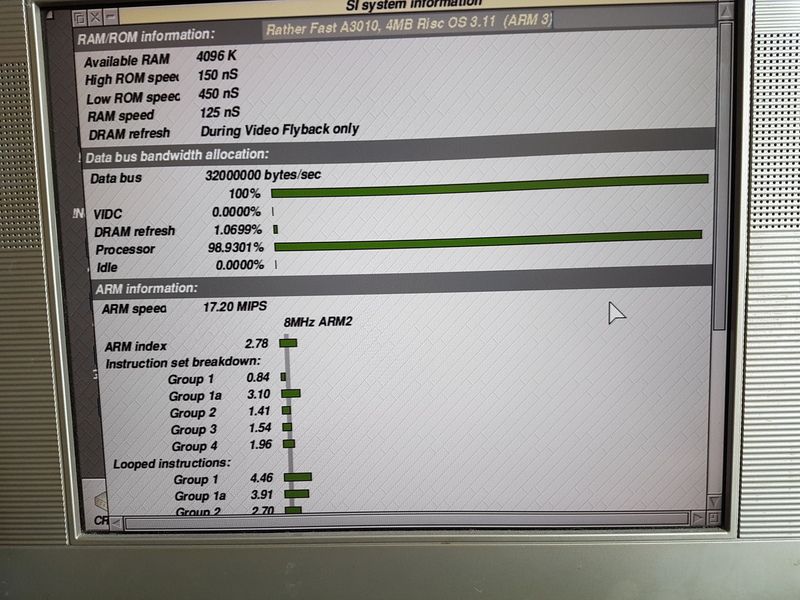

Apologies for polluting this thread but I managed to get a more accurate version of the !Si application from Jonathan Abbott, it shows my machine is running a bit quicker :twisted:
that's peak MIPS, reliably it is 17.04. Peak achieved by me spamming the 'calculate' menu choice until I got something I liked the look of :roll: :lol:
Champing at the bit for faster ram chips and sockets to arrive now :lol:

A screenshot of the CPU Info screen would be interesting, to compare it against a stock ARM2:

I would question the accuracy of this !Si app, according to the screenshot your ram is clocked at 125NS :shock: , it should be about 80NS for 12MHZ RAM? I ran it myself and it also says my RAM is 125NS when !ArmSI correctly reports it as 45NS (22MHZ). !ArmSi also calculates the ROM speeds and data bus speeds correctly for my machine whereas !Si is way out.
I'm not sure of the difference between !Si and !ArmSi (their icons look the same :D ) but I'm sticking with !ArmSi. I guess the extra couple of mips came about by disabling the video DMA? :D

vectorlight wrote:I would question the accuracy of this !Si app, according to the screenshot your ram is clocked at 125NS :shock: , it should be about 80NS for 12MHZ RAM? I ran it myself and it also says my RAM is 125NS when !ArmSI correctly reports it as 45NS (22MHZ). !ArmSi also calculates the ROM speeds and data bus speeds correctly for my machine whereas !Si is way out.
I guess so. Just out of interest what version number do you have? My whole search for newer versions was to get results comparable to Chris' Acorns. He used v4 but I can't get that working.
!Si is the original that I wrote in 1990. !ArmSi was a modified version of my app, with various bits modified/added/removed.
!Si reads the RAM/ROM speeds from the chipset, it doesn't attempt to calculate if the crystal has been changed. It was written very early in the Archimedes timeline, so wasn't updated as newer models came out, or people started tinkering with the hardware. The CPU/FPU/MIPS timings are accurate though.
Yes, the MIPS difference would have come from the video DMA or IRQ/FIQ being enabled when !ArmSi did the instruction speed tests.
I'd forget the main info screen which is just an overview, it's the CPU and FPU info pages that give you a true idea of how fast the CPU core/FPA are.

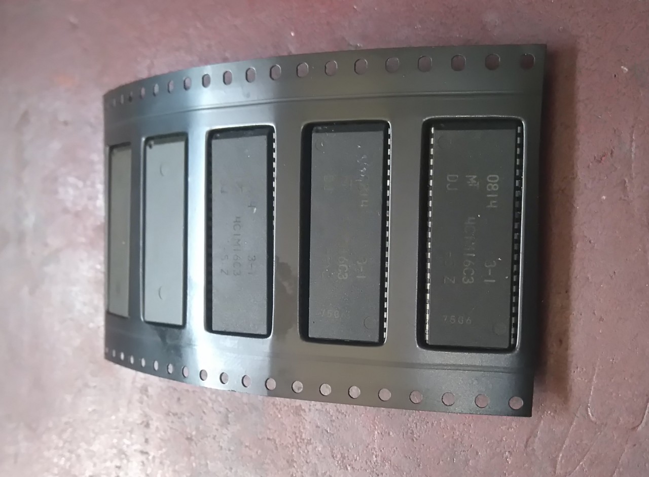

Look what arrived in the post today, some 50NS RAM: :D

sirbod wrote:!Si reads the RAM/ROM speeds from the chipset, it doesn't attempt to calculate if the crystal has been changed. It was written very early in the Archimedes timeline, so wasn't updated as newer models came out, or people started tinkering with the hardware. The CPU/FPU/MIPS timings are accurate though.
Thanks for the clarification Jon, that clears it up. :D

vectorlight wrote:Look what arrived in the post today, some 50NS RAM: :D
Quite strange all the markings seem to have vanished ...

Zarchos wrote:Quite strange all the markings seem to have vanished ...
Yeah, don't know whats going on with the markings. They work alright though... :D
