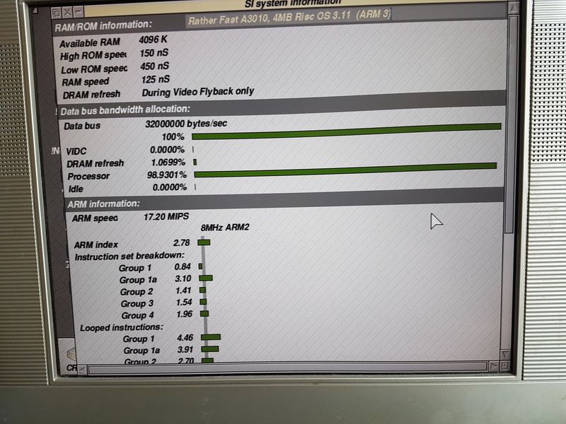

ImagePS I had 17 ish mips out the A3010 standard with only 30mhz OC.
Something to compare with.

The ARM3 on its own, btw, gives 14MIPS in ArmSI. So 17MIPS for the same module on an Adelaide A3010 purely due to the faster 12MHz RAM is quite a lift.
