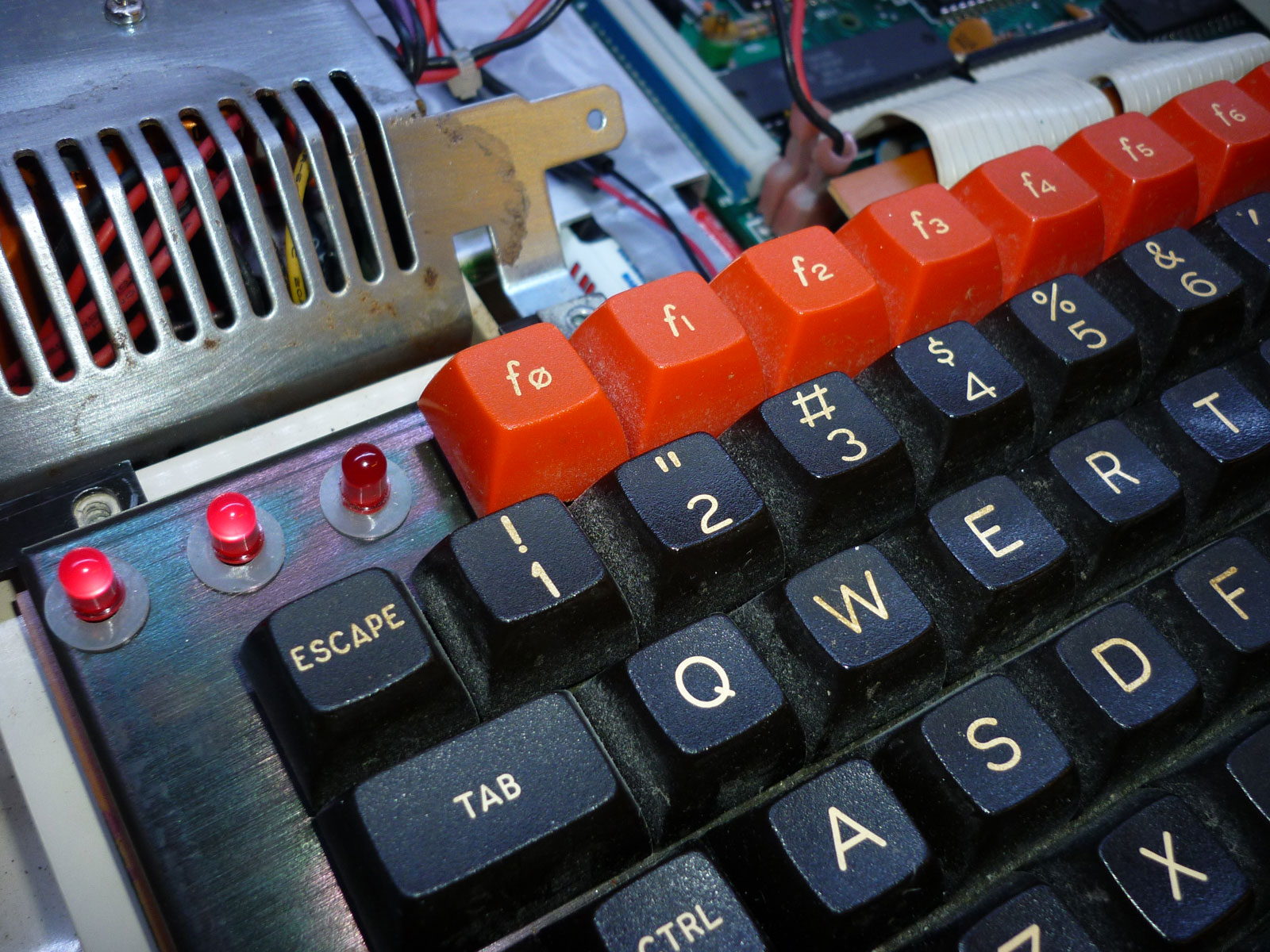

Think I've found the problem. Power light comes on if I wiggle the ribbon cable connector

Master 128 LEDs Not Working
While fixing the floppy drive control on a Master 128, I've found that the keyboard LEDs have failed. Initially just the Caps Lock and Shi f t :oops: Lock but now also the Power LED. When I first bought it, all three worked fine. The Lock keys do do what they are supposed to and the rest of the keyb...

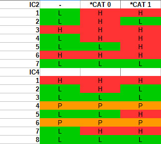

Interesting probe results from IC2 and IC4 with the new board (previous results from original board on the right):

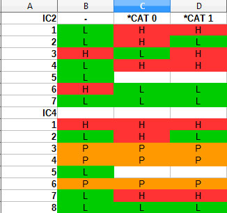

Pin 5 on IC2 and IC4 is where the fault lies, hence IC2 pin 6 is not producing a correct output. Fun part is figuring out which of the two ICs is faulty. Thanks. That's sort of what I'd figured but wasn't sure if the fault was actually in one of these ICs. Is the only way to swap one at a time? The...

This morning I've taken some readings with the logic probe with both drives connected which I've summarised here: https://s3-eu-west-1.amazonaws.com/quokkaz/bbc/probe-results-1.jpg Column B shows the status at startup, then C and D are after doing a *CAT on each drive. Drive 1 works consistently and...

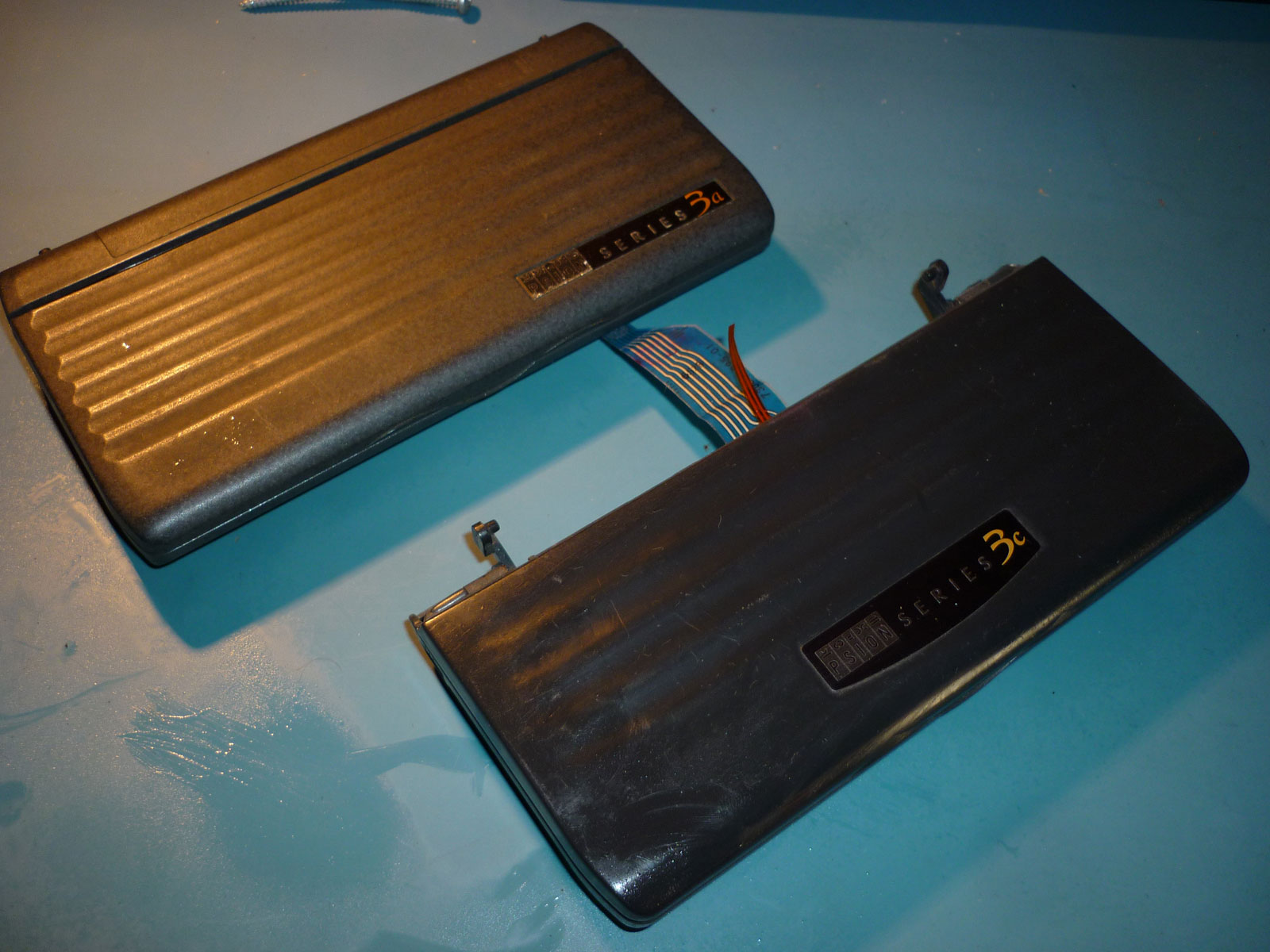

I've not seen a Psion 3c in the "flesh", so to speak, but does it by any chance have one of those "rubbery" type coverings? If so I've known a few devices with such "grip finishes" where the coating has started to break down and goes very very sticky. One was a Microso...
- Wed Aug 26, 2015 8:57 pm
- Forum: general
- Topic: Today I received.....
- Replies: 6086
Re: Today I received.....
Received today: an extremely sticky Psion 3c needing a new hinge (for which I have a donor). Can't imagine where it's been - it's like fly paper.
