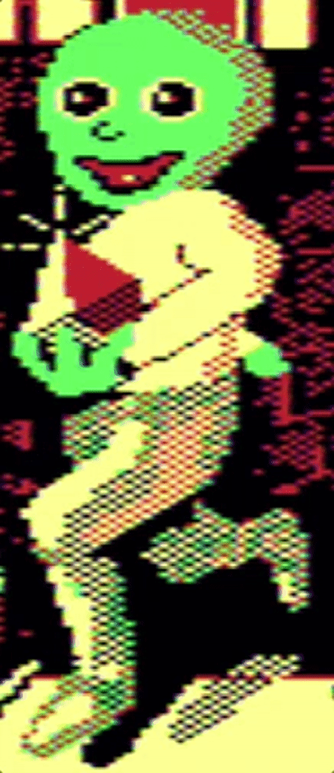

Quick note to add: I just made an additional release that was intended to fix a Vic-20 colouring problem — specifically a phase error introduced during intermediate processing for its particular sub pixel alignment — but actually appears also to have fixed all output problems on the 2013 Mac Pro.
My best guess is that because even the 1d composite signal is packed into 2d for the GPU's benefit, I was introducing "vertical phase" errors, effectively jumping an irregular amount of time into the future for certain segments. I'm not completely sure I believe that but the only Mac Pro I have access to is the one that sits on my desk at work so I haven't ever had an opportunity properly to diagnose the problem. I just grab five minutes every so often to test the last thing I uploaded. Therefore a guess from perceived symptoms is as good as it's going to get for now.
And, empirically, the problem is gone. So that's worth mentioning.
Monitor versus television state of play — as a quick reminder, the Electron interlaces all modes, so that's why there's a slight vertical fuzziness even in monitor mode:

That looks great! Exactly as I remember it!
Out of interest, at what rate are you sampling the luma signal? PAL has a maximum bandwidth of something like 5.5MHz, but I think (if I'm doing the sums right) that only results in an absolute maximum horizontal resolution (including borders) of 572 pixels (52us * 5.5 * 2). What kind of analogue effects are there when encoding the luma for a MODE 0 signal? It should ideally be a square wave, but in practice do you get inbetween-levels being output when sampling near an edge?
