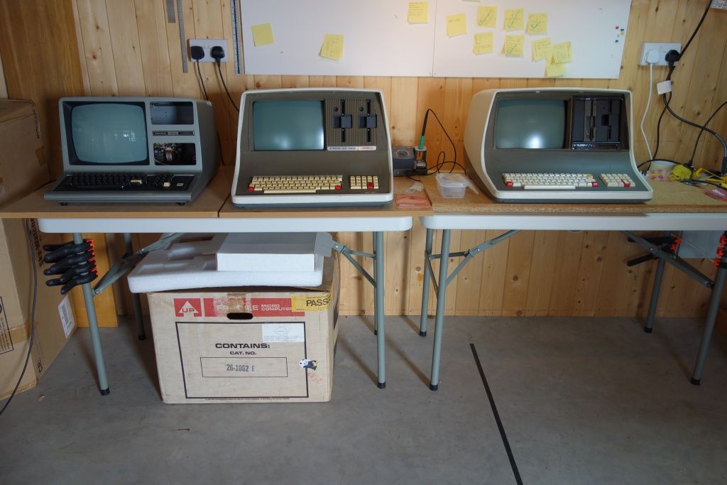

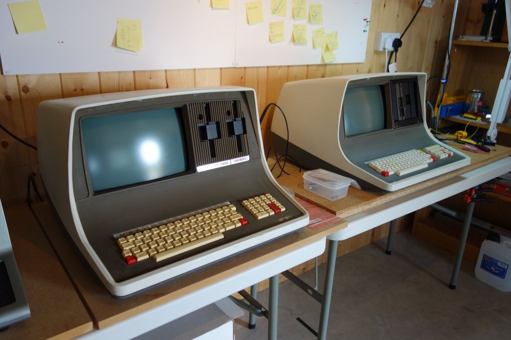

OK Jon, you've inspired me
Got a long weekend on my own coming up so I'm getting these prepped for some work.
The spare parts MIII gives you a sense of the scale of these things.
Neither of these two are working, but the one on the right has video output - sometimes a block cursor, sometimes a bunch of characters filling the screen. It's fitted with some additional boards, the purpose of which I'm not entirely sure just now. Someone has chopped up the top bezel at some point to accommodate a half-height drive. Nice clean white keyboard though and generally in really good nick and super clean inside.
The other machine was acquired for spares. The plan is to reinstate two full height drives in the better machine and replace it's bezel with the one from this fella.
The whole lot then needs a professional respray at some point.
The priority is to get the better machine fully working and I'll work on the cosmetics later.
Lots of fun right?!

Re: Alright.. who's got an Intertech Superbrain?
Is it me or is one of them grey, the other brown?

Yes the two machines are different colours, the left hand one has a definite suntan. Not sure what the front panel is painted with but seems to yellow like plastic. The right hand machine has been in museum storage for quite some time I guess hence the fresh appearance. The casework and panels are made from high density expanded foam which is common for machines of this era. Very tough and hard wearing material but susceptible to cracking if really abused. Same material that the original Apple ][ was made from but the brain cases (☺) are really heavy duty. The foam casing is painted so normally there's no yellowing. The top and bottom case halves on both machines show a little chipping etc but are very good for their age.
You would be welcome to the M3 screen but you wouldn't really want it. It's the standard analogue display common to the M3 and M1 TRS-80s - I.e. just a television. The M4 is fitted with a proper monitor tube with digital driver. Having said that, I'm not sure if you could drive the tube from the M4 board and get a better result. There was some discussion about this on the VC forum if I remember correctly. I'll see if I can dig it out.

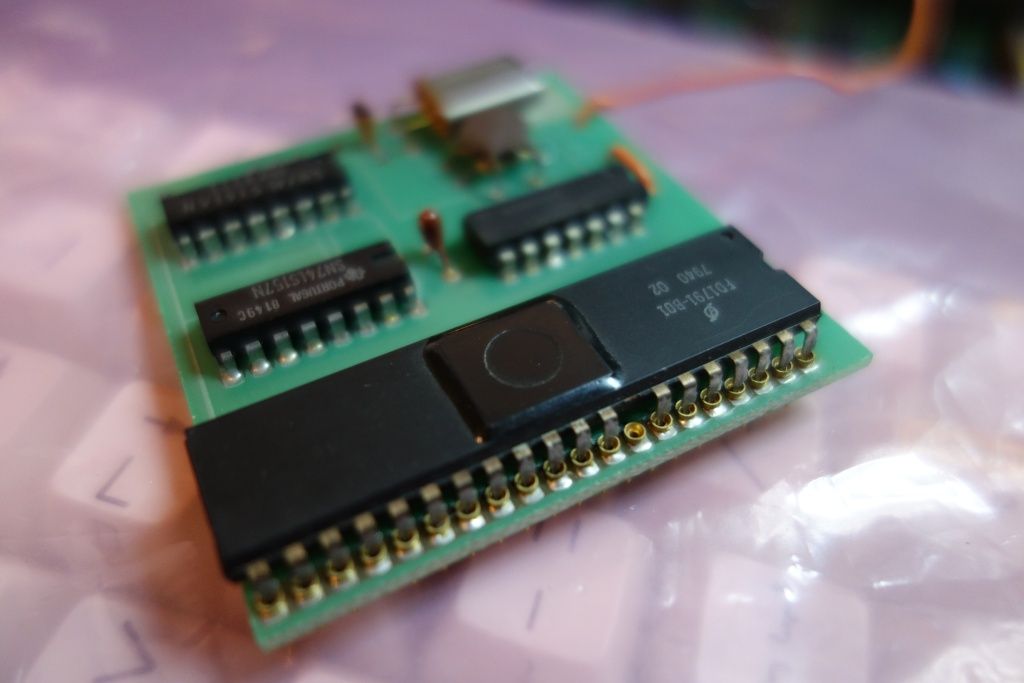

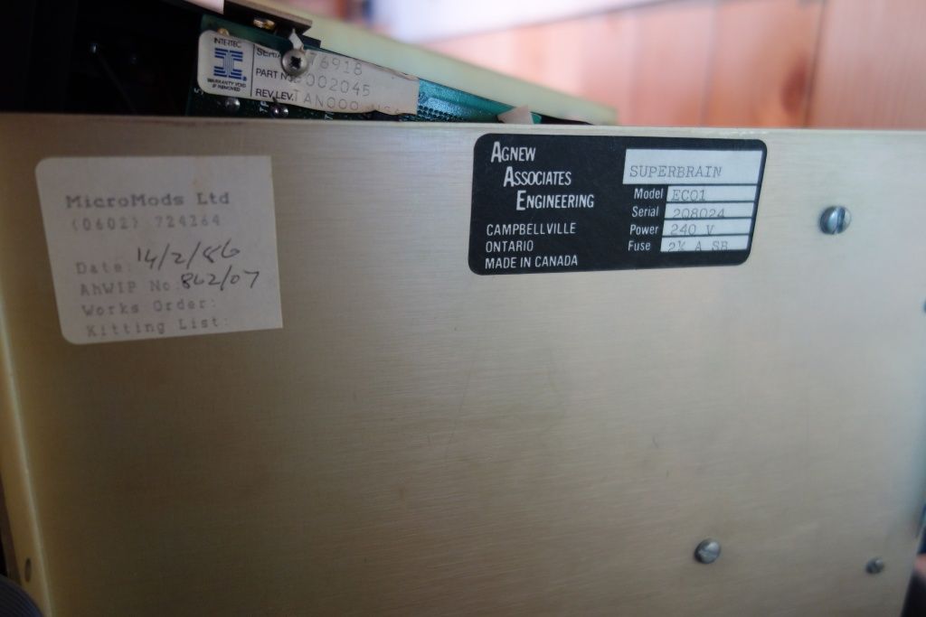

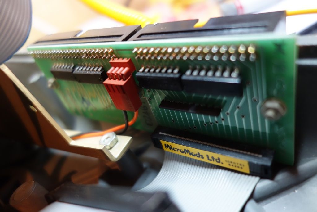

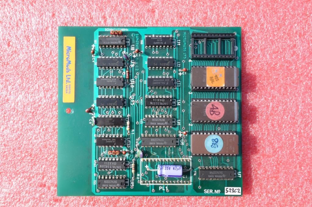

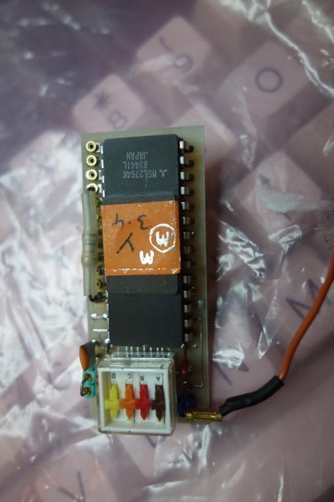

Some pics of the additional boards. I'll post hi-res versions of these and additional stuff up on my flickr page for anyone who's interested.
Seems that this machine had a make-over from a company called Micromods Ltd back in Feb 1986. The modifications comprise five boards:
Overview:
#1. A large board replaces the socketed CRT8002 character generator and is labelled 'Supervid':
#2. A board replaces the Boot ROM (2716) with a 2764 EPROM with DIL switch:
#3. A small board re-sockets the FD1971 disk controller with crystal and a few bits of logic - note the snapped off pin - this must be deliberate as the same pin is snapped off on my other system:
#4. Another small board re-sockets the INS8255 PIO - just some flying leads and a SIL resistor (see main photo).
#5. Finally, sneeking around to the side of the machine, a buffered (I think) breakout board to access expansion from outside the brain case:
Evidence... Micromods and Agnew in Canada?? Interesting.

I see. That board with the three ROMs must be alternative character sets. I read that Superbrain I has no proper lower case descenders, but this is fixed by SBII. I'll wager that board is doing likewise.
I bet the single rom is the SUPERBIOS thingie. Would love to see a dump of it, can you read it with an EPROM programmer? Not sure it needs an updated BIOS just to boot from a high density floppy. All it does is load the boot sector off the floppy, but what are the switches for? Hmm...
The FDD controller must be to support the added drive. I bet it's DS DD 80 track 720k. I doubt the normal controller can do that, but you also need an upgraded FORMAT.COM to take advantage of it. You got the boot disk, right?
So to your screen problem. I recon the video board is playing up. Have you checked all the connections, reseated all the boards, checked for folded under chip legs?
By the way, there is a common problem with these machines, apparently. The boot ROM loses it's content over time. To fix it, you just reblow the EPROM and job done. This could be an easy fix for your non working machine.
What I'm saying is we might be able to get both of them working....
These are just random thoughts. I won't get mine until it's got a new boot ROM and been resprayed. About a fortnight, but in the meantime I have the TRS80 Model 4 to play with. Got XMODEM working last night.. Small steps....

Replaced the supervid board with the standard char gen and still just get a static cursor.
Potentially lots wrong with this machine. However I'm determined to get it working.
The guy who is selling it. I am sure he would be prepared to do yours, but let's see how good the finished item is. He's doing the ROM and spraying with two coats of lacquer. It's going to look like new, I hope...
OK sounds good. Would love to see how that goes as I have loads of systems here that could do with a respray from a professional. Not sure why your man is messing around with the ROM though...
(Edit ...ah right you said it needed a new boot ROM).
I'll see if I can get my ROMs read at some point today.
I meant to ask you - are either of them "QD" models? You can tell by looking at the label below the disk drives, if they are still there. This may be significant for the BIOS.
Yep both are QD.
A little more on the boards from the 'Superletter - Serving SuperBrain® Owners and Users Around the World', April/May 1981 - new products:
MICROAGE CONSULTANTS
53, Acton Road, Long Eaton
Nottingham NGI0 IFR
England
(06076) 64264
Contact: Andrew Billson
HARDWARE: SUPERBIOS is a
strong product from these English
SuperBrain experts. It contains a
real-time clock, XON/XOFF or
ETX/ACK protocols, repeat and
type-ahead keyboard functions,
compatible with their own designed
8" hard-disk system with the
Decitek 8000/S. Also, the product
makes W ordstar workable.
S UPERVID is a product of their
MicroMod division. It permits dim
video, reverse video, blinking and
underline, line drawing and graphics,
lower-case descended, attributes
mixed on the screen and three alternative
character ROM sockets so
that you can use chess symbols,
APL, etc. Distribution of their products
will be handled by special
dealers on both American coasts.
They'll be introducing a new
INTERFACE CARD for Seagate
Technology'S ST-506 5" Winchester
Disk providing 5 Meg storage inside
the cabinet.
I'll make a copy of the standard ROM (It has the Intertec label on it so should be original) and the MM SuperBios.
Great, thanks. I expect you will find the Intertec ROM is blank, but perhaps not.
QD, that's good news. They won't be Superbrain IIs because that one has several of the BIOS enhancements you mentioned, so there would be no need to fit an add on.
I think cloning the Multi Character rom and BIOS board would be very nice, but I'd need your help. First off, I'd need hi rez pics of both sides of each board with socketed chips removed, so we can draw up a circuit diagram. How do you feel about dismantling it all?
(also lists of the components used)...

Also... Just noticed on the schematic that it should support an additional two disk drives out of the box, so I will be able to make images using my HxC emulator, hopefully by splicing it into the internal drive cable and setting it as drives 2/3.
